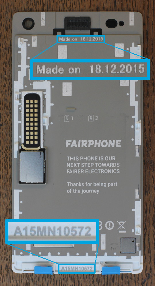

Display Module
The unique identifier of the Display Module is located on the back of the module, between the two blue clips. It is composed of 10 characters (letters and digits) and starts with an A, e.g. Axxxxxxxxx.
Depending on the version of the display you have, the manufacturing day of the frame might be engraved on the top of the back side, e.g. Made on 18.12.2015.

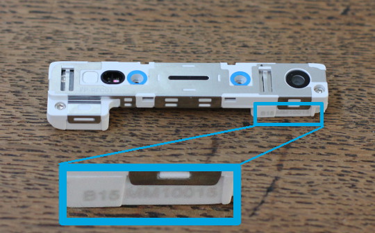

Top Module
The unique identifier of the Top Module is located on the underside, close to the front camera. It is composed of 10 characters (letters and digits) and starts with a B, e.g. Bxxxxxxxxx.

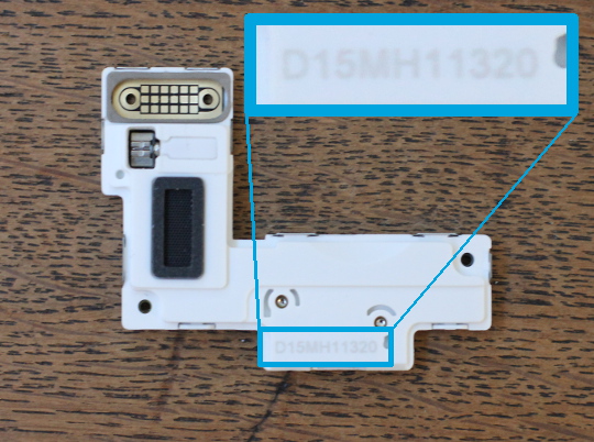

Bottom Module
The unique identifier of the Bottom Module is located on the back, on the bottom under the screw holes. It is composed of 10 characters (letters and digits) and starts with a D, e.g. Dxxxxxxxxx.

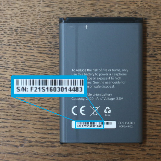

Battery
The unique identifier of the Battery is located on its back. It is composed of 14 characters (letters and digits) and starts with a F, e.g. Fxxxxxxxxxxxxx.
