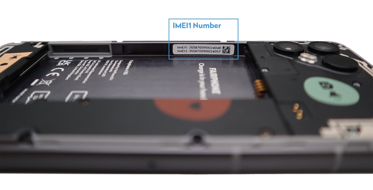

1. Find the IMEI 1 of your device:
  • On a working device: go to SettingsAbout phone → scroll down to IMEI (SIM slot 1).
  • On a non-working device:
    1. Take off the battery cover.
    2. Take out the battery.
    3. On the side of the battery housing of the Core Module, there will be a white sticker with the IMEI and a barcode. Click to see how it looks on the Fairphone 3 and Fairphone 4.
  • Printed on the underside of the original box of delivery.
  • Printed on the delivery note.
