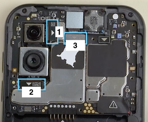

Remove a Camera
  1. Each camera is connected to the motherboard with a BTB connector:
    • The Main Camera's connector is on right (1).
    • The Ultra-Wide Camera's connector is below it (2).
    • The Front Camera's connector is below it (3).
      connector_locations
  2. Use a plastic card or pick to disconnect the BTB connector of the camera you are removing.
  3. Lift out the camera. You may use the plastic pick for support.

Install a Camera
  1. Simply place the new camera spare part in its correct location. You may use the picture from the step "Remove a Camera" for guidance.
  2. Press the BTB connector firmly until you feel a soft click. Both the camera spare part and connector should be flat.
