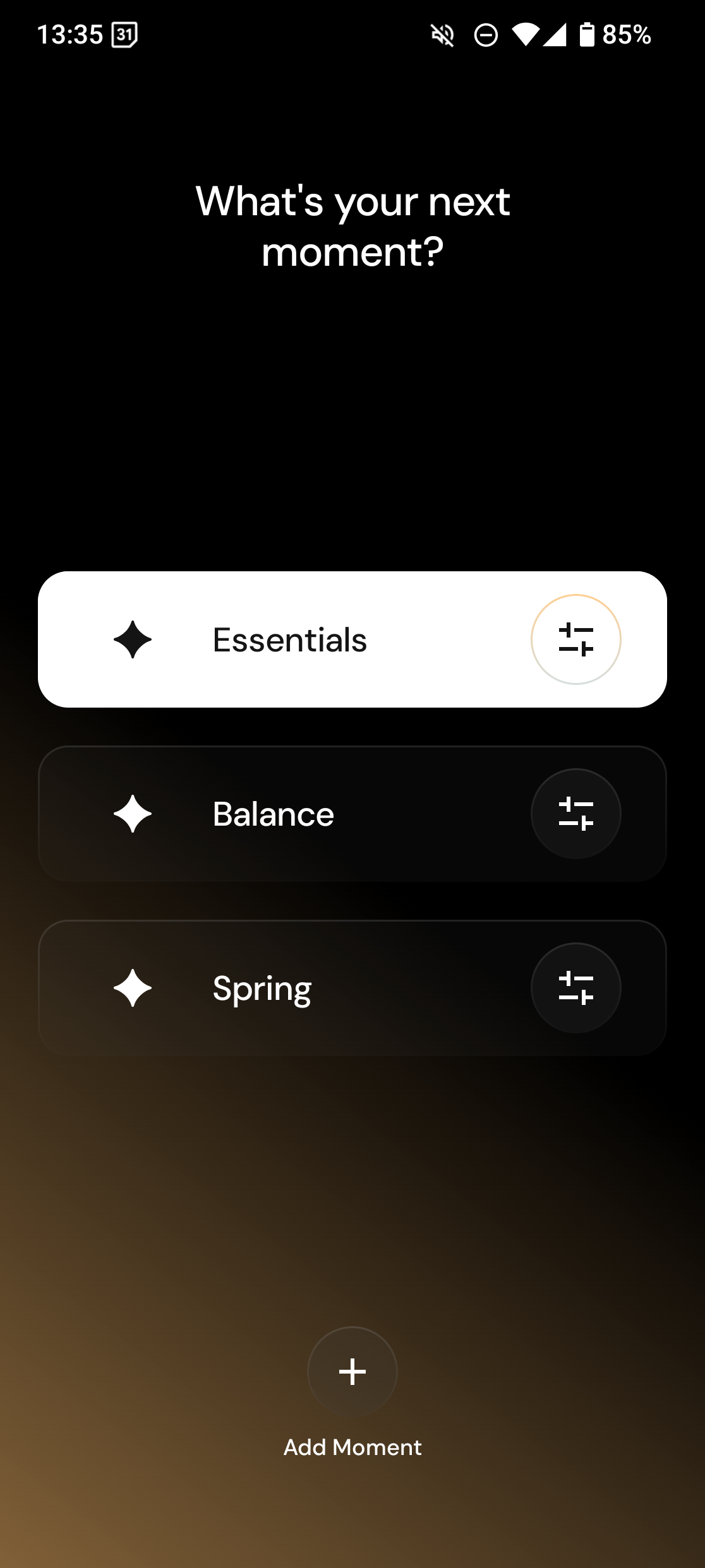

How do I create a new Moment?
When you have Fairphone Moments enabled you will see a main action button right underneath the date-time element with the name of your currently enabled Moment. Clicking this will lead you to the moment switcher from which you can activate or create a new moment.
Creating a custom moment allows you to build it from scratch. Next to creating a fully custom moment you can choose from any of the presets below to give you a head start:

As well as the apps featured you will also be able to choose a wallpaper, name and icon for your mode. Any of these settings can be adjusted by clicking the settings button to the right of the Moment you wish to modify, in the main moment switcher.
In total you can have up to six different moments set up.

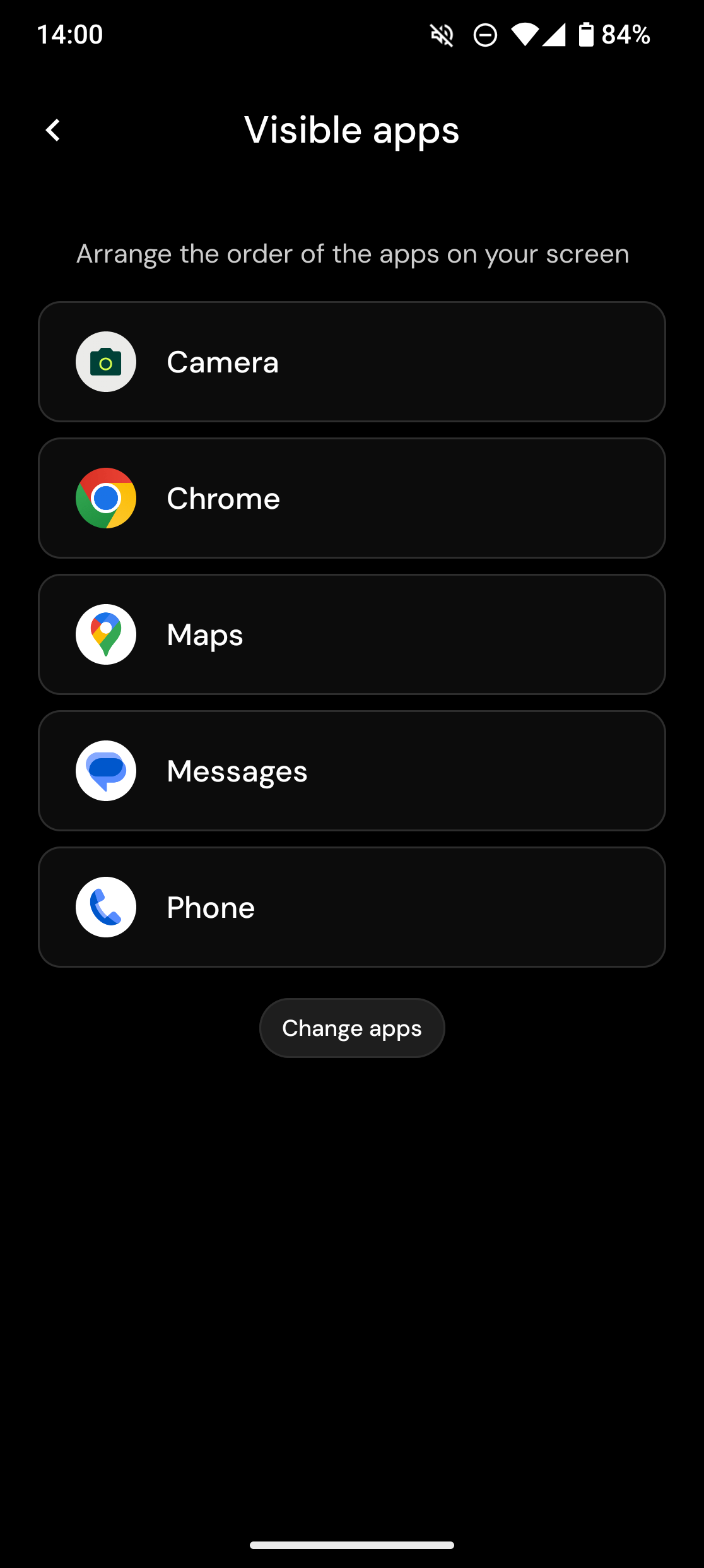

How do I select the Visible Apps?
The visible apps setting adjusts the apps that are visible on your launcher. These are the apps that you will continue to have easy access to while using this moment. You can also select apps from your work profile. These will have a work profile icon next to them and can be accessed just like the others. You can list a maximum of five apps per moment so choose wisely.
Adding an app to the list of visible apps does have an impact on you receiving notifications from it. By default these apps will not send you any notifications unless they originate from any of the contacts or apps that you have allowed to disturb you. Keep in mind that any app running prior to you enabling Fairphone Moments will continue running in the background.

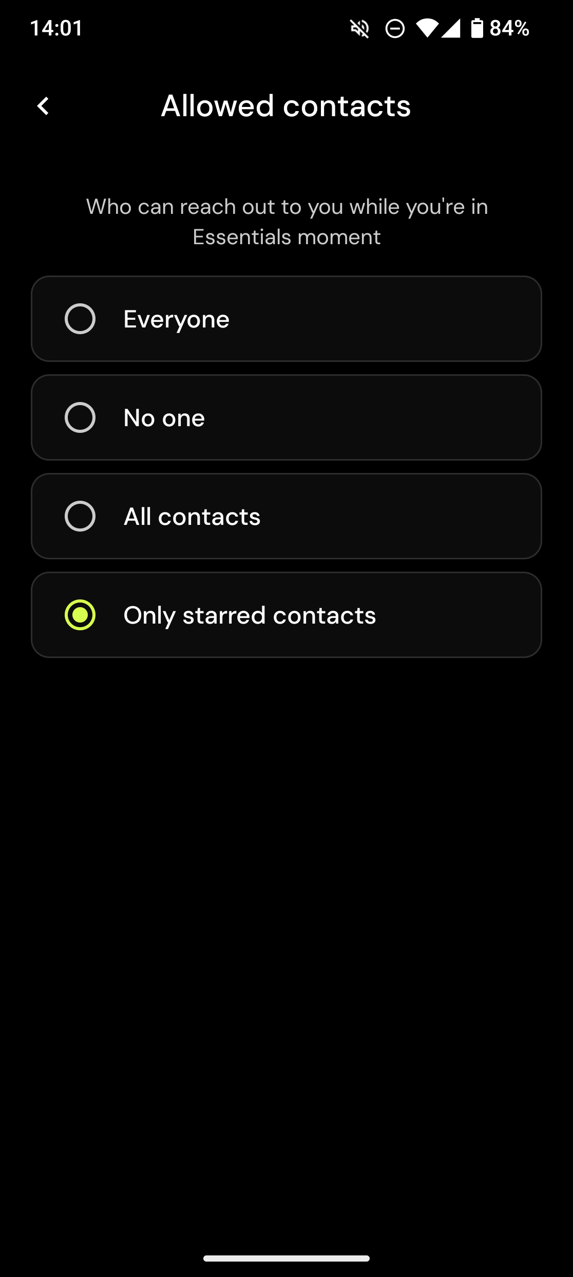

How do I choose allowed contacts and Notifications?
This setting will allow you to indicate who can reach out to you while you have this Moment enabled. It is similar in working to the people setting of Android’s Do Not Disturb. By default Allowed contacts will be set to only starred contacts. This means that any contacts you starred in the default Android contacts app will have their notifications from calls, messages or third party apps go through.
Keep in mind that the logic extends to third party (messaging) apps only if those apps integrate with the Android Contacts Library and permissions have been given by the user to access these.
Contact inclusion rules take priority over any rules set up in App Notifications. This means that if one of your contacts, that is allowed to contact you while this moment is active, contacts you via an app that is not specifically included in the app notifications rules the message will still go through.

Q: If Signal is not added as an app that can send me notifications but one of my included contacts sends me a Signal message. Will it go through?
Yes, contact inclusion rules have priority over app inclusion rules. This means that if you add a contact to your inclusion rules, any notification your receive from them will go through, regardless of if the app they send it from is in your app inclusion rules.

Q: How many apps can I feature on my Fairphone Moments homescreen?
You can feature a max of 5 apps per moment on your home screen.
Q: How many moments can I create?
You can create a max of 6 moments.
