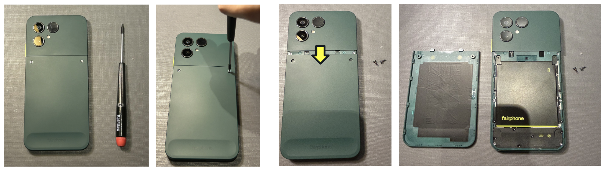

Removing the back cover
  1. Power off the phone by long pressing the Power button. Depending on your settings, press the Power button and Volume Up button together to open the power menu.
  2. Place the phone on a flat surface with the screen facing down.
  3. Remove the two screws on the top left and top right of the lower back cover.
Outer screws are longer than inner screws. Keep your outer and inner screws separated so reassembly is easy.
  1. Slide the lower back cover off toward the bottom of the phone.
Four photographs showing how to remove screws and slide off the back cover

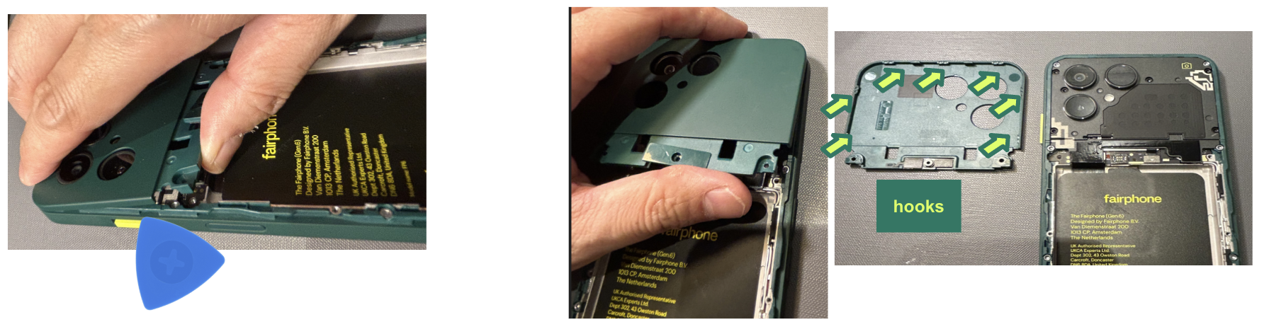

  5. Unclip the plastic hooks locking the upper back cover in place. Use a plastic card or pick to unclip the plastic hooks to avoid damaging your back cover or fingers. Start from the bottom left and right, then work your way upward on both sides.
  6. Set the battery and upper back cover safely to the side.
Three photographs showing the removal of the hooks in the upper back cover

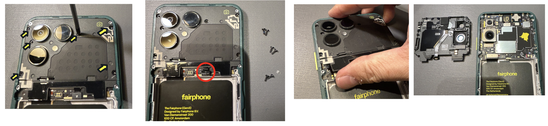

Removing the top unit
  1. Use your Torx T5 screwdriver to unscrew the six black screws holding the top unit in place.
  2. Keep all six screws safely inside your container.
  3. Lift out the top unit with a plastic card or pick, using the same technique you used for the upper back cover.
Four photographs showing how to remove the top unit
