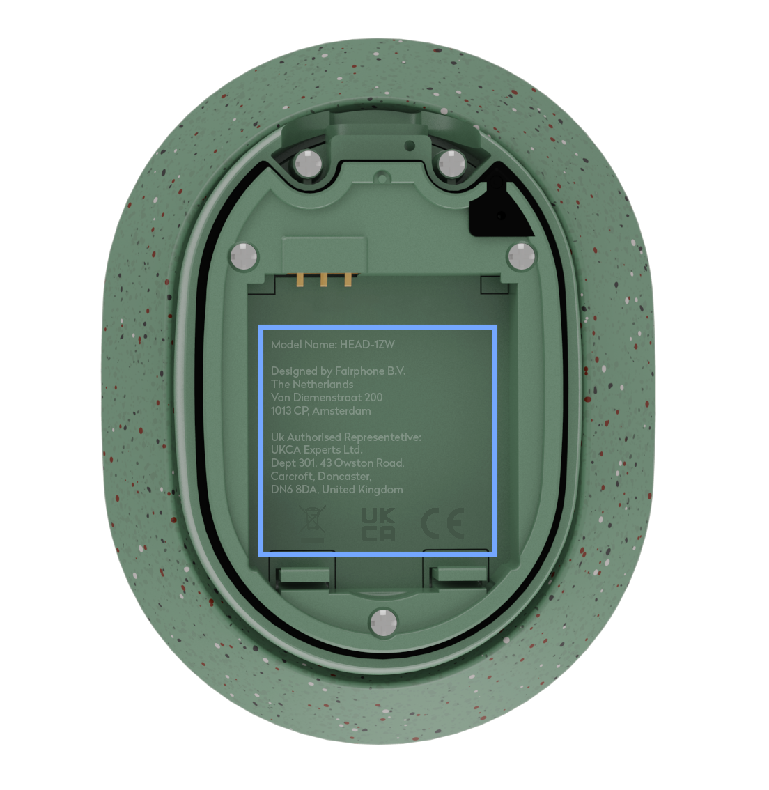

Information on CE markings and Serial Number
For audio devices purchased before 31st May 2025, the CE marking and the administrative markings (model name, company name and address) are placed beneath the battery. The battery can be easily removed by following the instructions in our support article.
You can find the markings on the Fairbuds XL, as seen below.
You can find out if the Fairbuds XL were made before or after this change via the Serial Number (SN), which can be found in the battery compartment or on the original packaging. If the SN starts with H2, H3 or H4, it was produced before. If the SN starts with H5 or higher, it was produced after.
For more information on the markings you can read more here.
