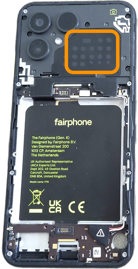

The Fairphone (Gen. 6/Gen. 6+)
Located under the upper back cover on the top unit.

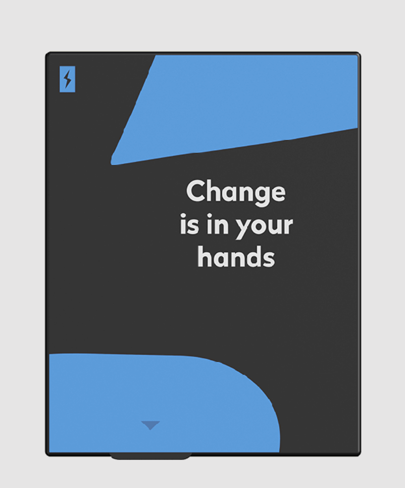

Fairphone 5
Located under the surface of the battery below the back cover.

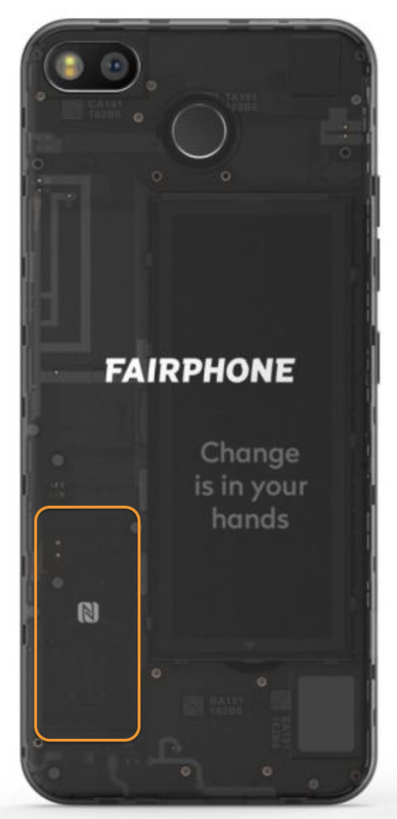

Fairphone 3(+)
Located in the core spare part on the lower left side of the phone, below the icon printed on the back cover.
