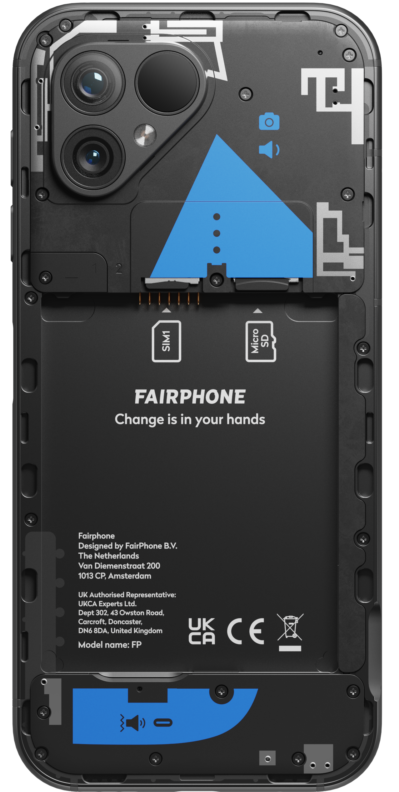

Where can I find the CE markings on older devices?
For all 256/8GB variants, and all 128/6GB devices purchased before 31st July 2025, the CE marking and the administrative markings (model name, company name and address) are placed beneath the battery. The battery can be easily removed by following the instructions in our support article.
You can find the markings on the Fairphone 5, as seen below.
You can find out if the Fairphone 5 was made before or after this change via the Serial Number (SN), which can be found in the battery compartment or on the original packaging. If the 9th digit of the IMEI number is 4, the device comes with a more visible CE logo. If it is 0, 1, 2, or 3 ( 9th digit), the device has the CE logo beneath the battery.
For more information on the markings you can read more here.
