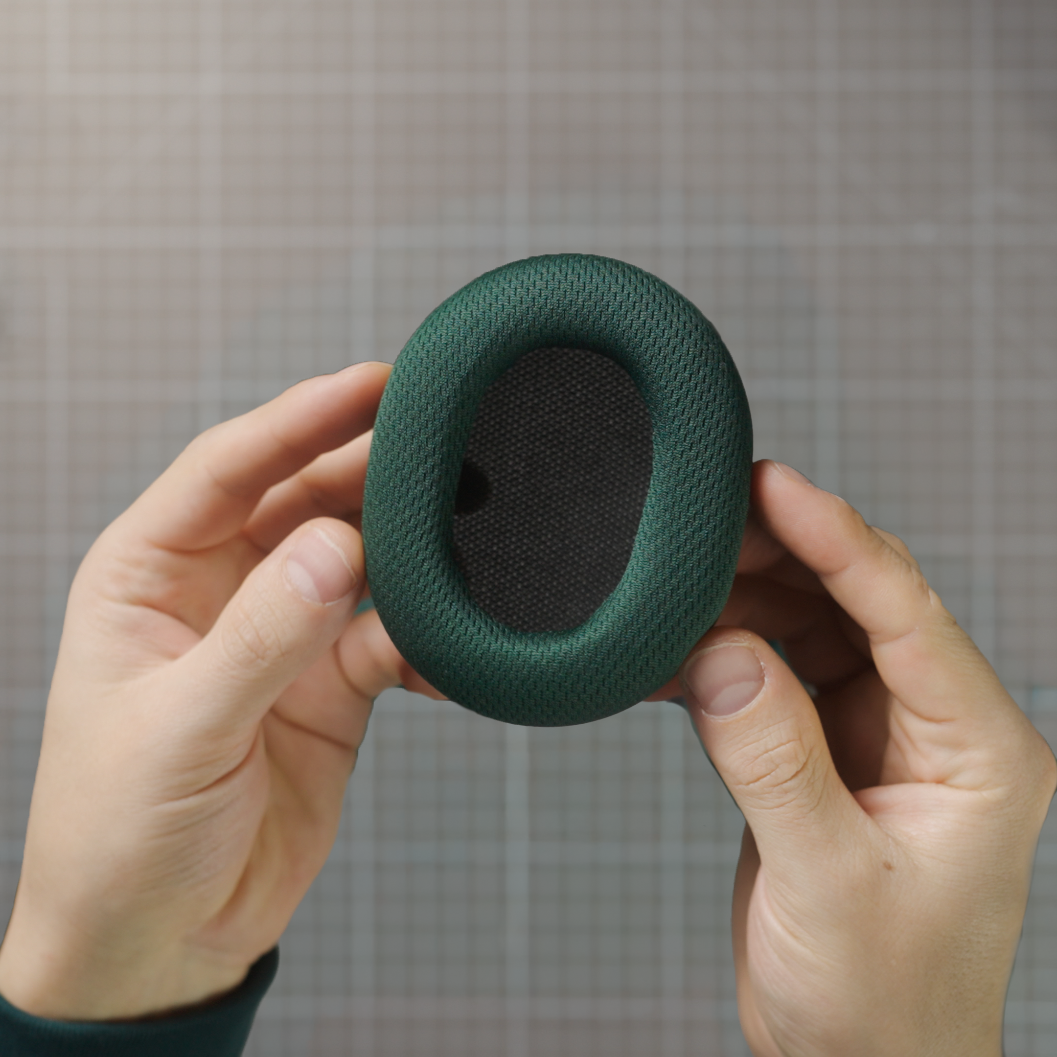

Cleaning the Fairbuds XL (2025) Cushions
  1. Remove the cushions by rotating them. To ensure you remove them correctly, please, refer to our video on how to do it in Ear Cushion replacement.
    This image displays the removable component ready for cleaning.
  2. Put the cushions on a flat surface with the textile facing up.
  3. Prepare the solution: In a clean container, mix 1 tsp. (5 mL) of liquid laundry detergent into 1 cup (250 mL) of water.
  4. Dip a lint-free cloth into the soapy water solution, wring it out slightly, and rub the cloth on the cushions and the headband (the main non-removable part) gently for 1 minute each.
  5. Wipe the cushions and headband clean with a separate cloth that's slightly dampened with fresh water.
  6. Dry the cushions with a soft and lint-free cloth to remove excess moisture.
  7. Lay the cushions on a dry surface and leave them until fully dry before re-attaching them (this may take up to a day).

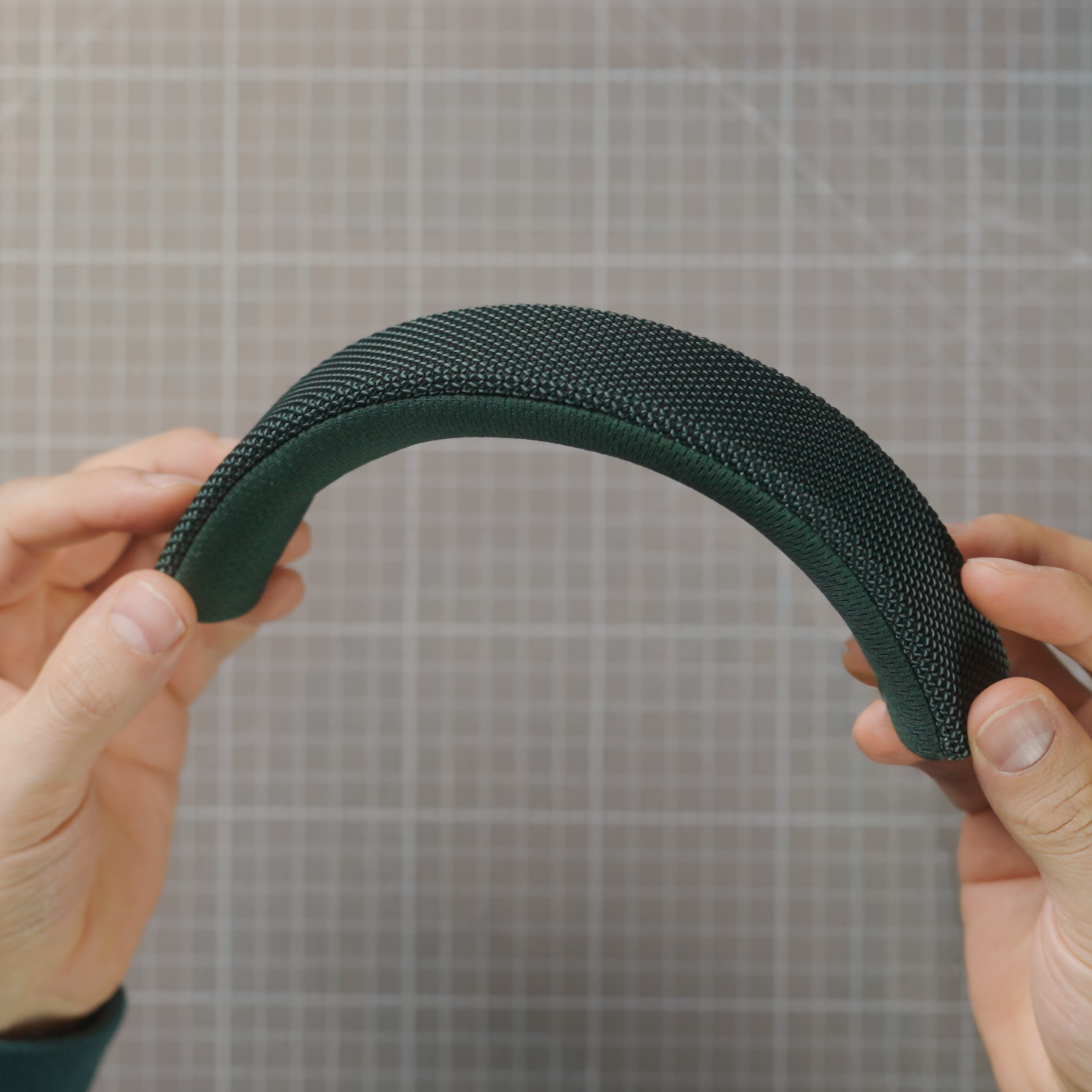

Cleaning the Fairbuds XL (2025) Headband Cover
  1. Remove the headband cover. To ensure you remove it correctly, please refer to our video on how to do it in Headband Cover, Headband, and Cable replacement.
  2. Put the headband cover on a flat surface with the textile facing up.
  4. Dip a lint-free cloth into the soapy water solution, wring it out slightly, and rub the cloth on the headband cover and the headband (the main non-removable part) gently for 1 minute each.
  5. Wipe the headband cover and headband clean with a separate cloth that's slightly dampened with fresh water.
  6. Dry the headband cover with a soft and lint-free cloth to remove excess moisture.
  7. Lay the headband cover on a dry surface and leave it until fully dry before re-attaching it (this may take up to a day).
