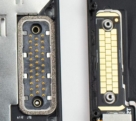

To prevent damaging your Fairphone 3(+), be aware to avoid electronic discharge (ESD). When opening it, do NOT touch Fairphone 3(+) with your bare hands. Pay particular attention to touch either the pogo pin connector or the related connection pad (see picture below). We recommend using rubber or cotton gloves, or to ground yourself.

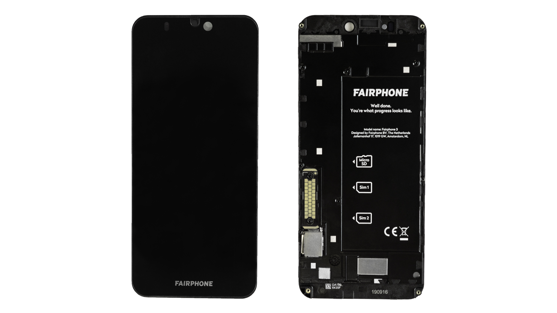

How do I replace the display on Fairphone 3(+)?
[Fairphone 3(+) Display Module front and back side]
The Fairphone 3(+) Display module consists of a 5.65 inch Full-HD display with a 18:9 ratio. The Gorilla Glass 5 provides increased scratch resistance.
After you have opened the Fairphone 3(+), you must remove the Display Module to access the other modules. In the video tutorial below, we show you how to separate and remount the Display Module from the phone.
To separate the Display Module from the phone:
  1. Remove the 13 screws that hold the Display Module in place.
  2. Place your fingers on the right side of the frame, inside the battery compartment.
  3. Push the display out of the frame.
  4. You removed the Display Module.
  5. The other modules are now accessible.
To remount the Display Module on the phone:
-IMPORTANT-
Your new display may include a plastic protective sticker for the Front camera opening. Make sure to remove this sticker before mounting the display.
  1. Start at the top of the frame.
  2. Click it into place one by one.
  3. Fasten the 13 screws that hold the Display Module in place.
  4. Place the battery back in, top first.
  5. Click the Battery Cover on the frame.
  6. Put the Protective Bumper on.
  7. Turn the phone on.
  8. You now remounted the Display Module and have access to the other modules.

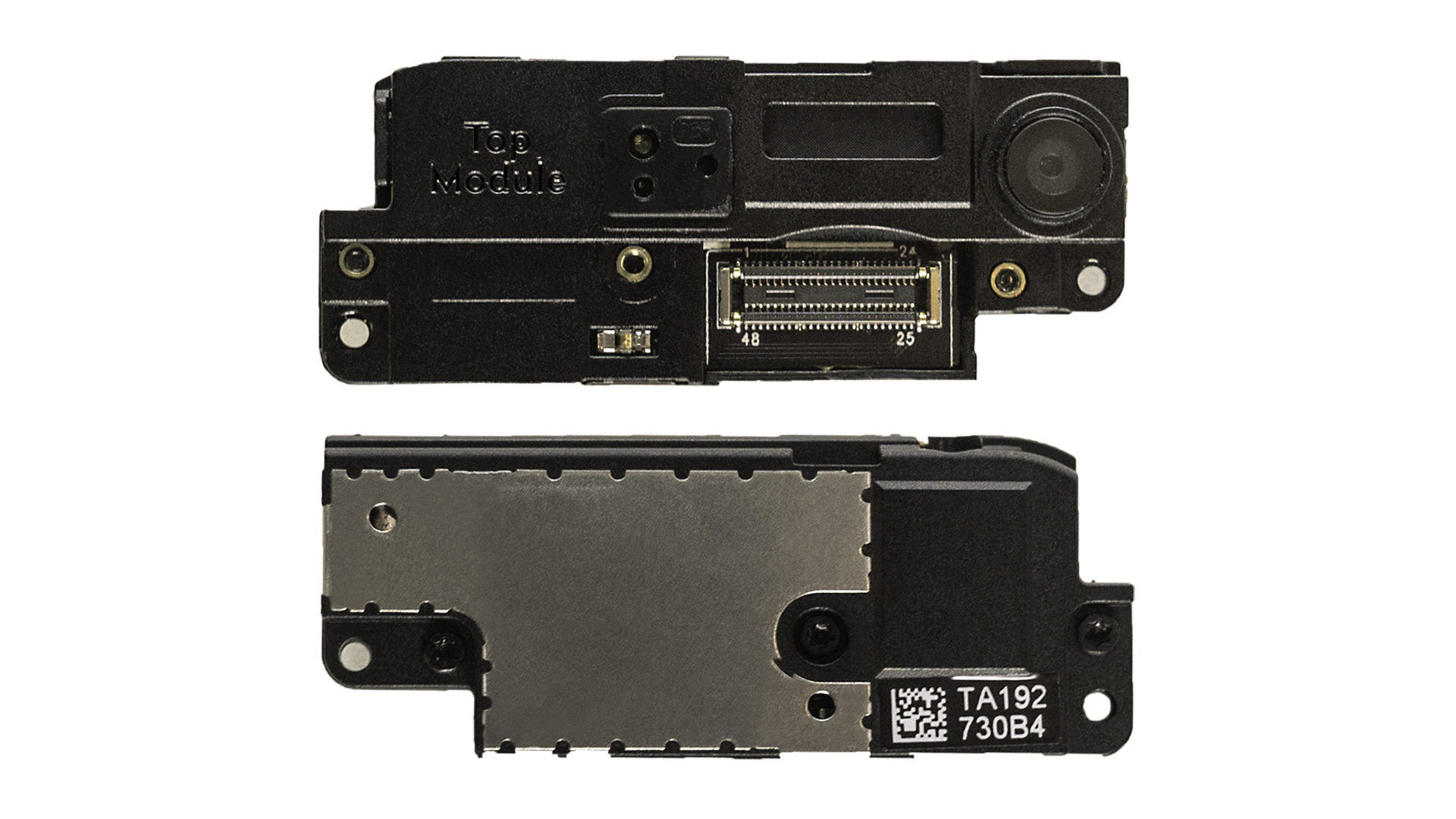

How do I replace the top module on Fairphone 3(+)?
[Fairphone 3 Top Module front and back side]
The Fairphone 3(+) Top module contains the Selfie camera (front camera), the receiver, the earphone jack, the secondary microphone (to filter out ambient noises), proximity sensor (to detect of an ear or head is nearby) and the brightness sensor.
In our video tutorial below, we show you how to separate and remount the Top Module from the phone.
To remove the Top Module:
  1. Lift the ribbon cable up from the top of the arrow to detach it. Preferably with a fingernail or a plastic spudger or plectrum.
  2. Remove the 2 screws holding the Top Module in place.
  3. Push the frame slightly on the back of the Top Module to remove it.
  4. You now removed the Top Module.
To remount the Top Module, proceed in reverse order:
  1. Put the Top Module back in its place.
  2. Fasten the 2 screws holding the Top Module in place.
  3. Gently reconnect the ribbon cable with your finger until you feel it click.
  4. Take the blue transparent foil off the camera lens.
  5. You have now remounted the Top Module.

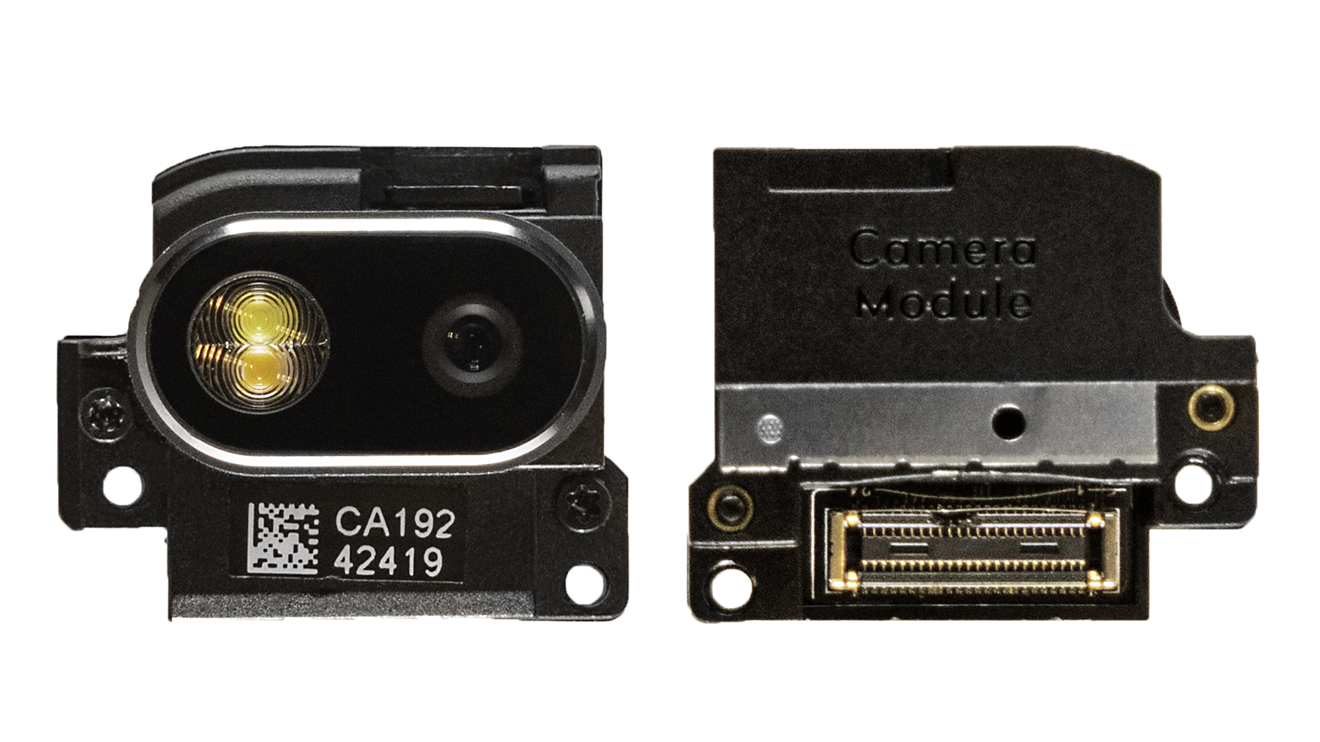

How do I replace the camera module on Fairphone 3(+)?
[Fairphone 3 Camera Module back and front side]
The Fairphone 3(+) Camera module contains the main - rear - camera, the light sensor and the flash.
In our video tutorial below, we show you how to separate and remount the Camera Module from the phone.
To remove the Camera Module:
  2. Remove the 2 screws holding the Camera Module in place.
  3. Push the frame slightly on the back of the Camera Module to remove it.
  4. You now removed the Camera Module.
To remount the Camera Module, proceed in reverse order:
  1. Put the Camera Module back in its place.
  2. Fasten the 2 screws holding the Camera Module in place.
  5. You now remounted the Camera Module.

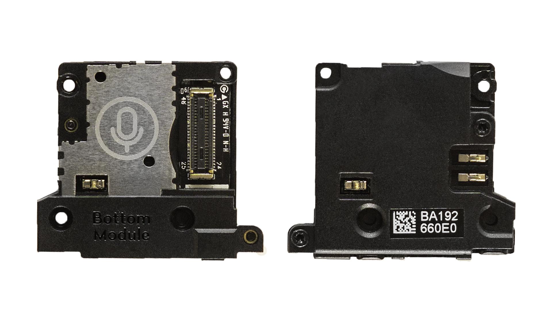

How do I replace the bottom module on Fairphone 3(+)?
[Fairphone 3 Bottom Module back and front side]
The Fairphone 3(+) Bottom module contains the vibration motor, USB-C connector and primary microphone of your Fairphone 3(+).
In our video tutorial below, we show you how to separate and remount the Bottom Module from the phone.
To remove the Bottom Module:
  2. Remove the 4 screws holding the Bottom Module in place.
  3. Take the Bottom Module out of the frame.
  4. You now removed the Bottom Module.
To remount the Bottom Module, proceed in reverse order:
  1. Put the Bottom Module back in its place.
  2. Fasten the 4 screws holding the Bottom Module in place.
  4. You now remounted the Bottom Module.

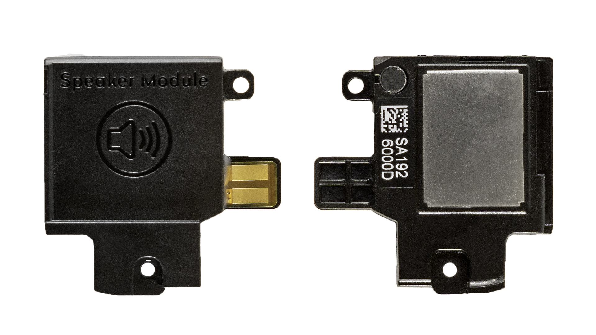

How do I replace the speaker module on Fairphone 3(+)?
[Fairphone 3 Speaker Module back and front side]
The Fairphone 3(+) Speaker module holds the loudspeaker that is used for calls, videos etcetera.
-IMPORTANT-
To access the Speaker Module, you must remove the Bottom Module first! In our video tutorial below, we show you how to first separate the Bottom Module and then the Speaker Module from the phone.
To remove the Speaker Module:
  1. Remove the Bottom Module first!
  2. Remove the (1) single screw holding the Speaker Module in place.
  3. Take the Speaker Module out of the frame.
  4. You now removed the Speaker Module.
To remount the Speaker Module, proceed in reverse order:
  1. Put the Speaker Module back in its place.
  2. Fasten the 1 screw holding the Speaker Module in place.
  3. You remounted the Bottom Module. You can now put the Speaker Module back in.
