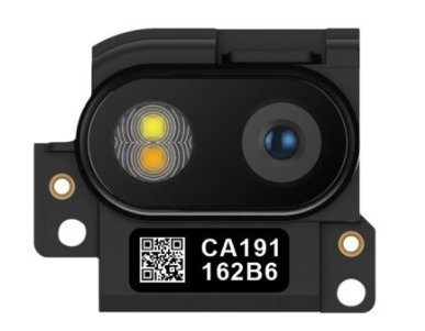

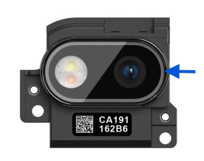

Camera Module and Camera+ Module
The original Camera Module is entirely black (picture on the left).
The Camera+ Module has a light grey outline on the inner side of the glass.

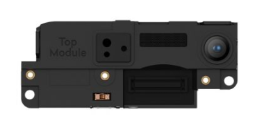

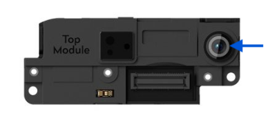

Top Module and Top+ Module
The original Top Module is entirely black (picture on the left).
The Top+ Module has a light grey outline on the inner side of the glass.

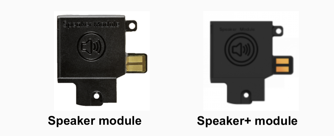

Speaker Module and Speaker+ Module
The original Speaker Module is escased with reflective/shiny plastic material.
The Speaker+ Module is encased with a mate plastic material.
