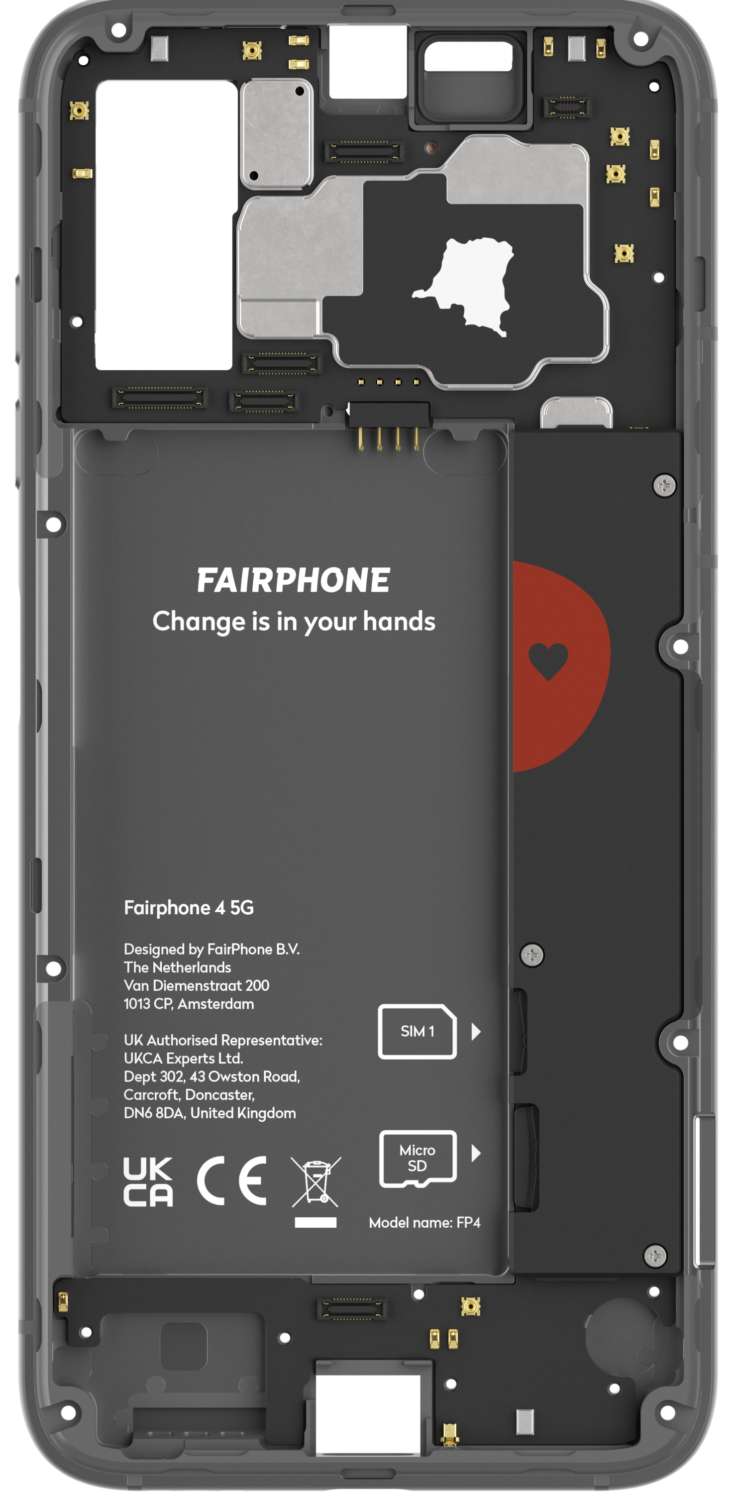

Where can I find the CE markings on my device?
The CE marking and the administrative markings (model name, company name and address) are placed beneath the battery. The battery can be easily removed by following the instructions in our support article.
You can find the markings on the Fairphone 4, as seen below.
For more information on the markings you can read more here.
