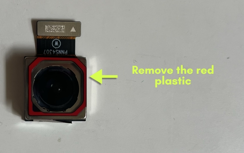

Once you remove the top unit, you should see all three cameras underneath.
Remove the Cameras
Each camera is connected to the motherboard with a board-to-board (BTB) connector:
- The Main Camera's connector is on the left (1).
- The Ultra-Wide Camera's connector is above it (2).
- The Front Camera's connector is in the middle (3).
Use a plastic card or pick to disconnect the BTB connector of the Camera.
Lift out the Camera. You may use the plastic pick for support.
-IMPORTANT-
Be gentle when handling a camera spare part.
- Do not bend the cable excessively.
- Avoid touching the lenses.

Install the new Camera
- Insert the new Camera in the opening.
- Press the BTB connector firmly until you feel a soft click.
